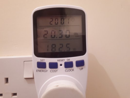

I don't know the running cost but it's a good question. I didn't notice a significant increase in our electricity bills so I guess it's not too much. Basically, it's just a very small refridgerator. But I recently bought one of these plug-in power monitoring gizmos https://www.amazon.co.uk/Energenie-429-856UK-Power-Meter/dp/B003ELLGDC so perhaps I should check.

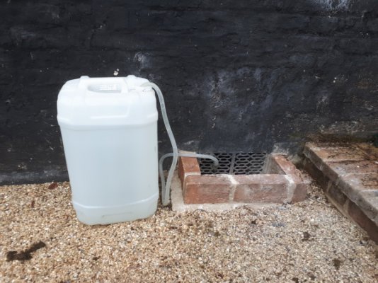

As for dehumidifiers being useless, perhaps I should post a video showing the outflow of my dehumidifier filling up a 20 litre water container over a week or two (depending on weather conditions)? That's water being removed from our cellar whichever way you look at it - maybe not by that video poster's preferred method of forced ventilation, but being removed all the same.
