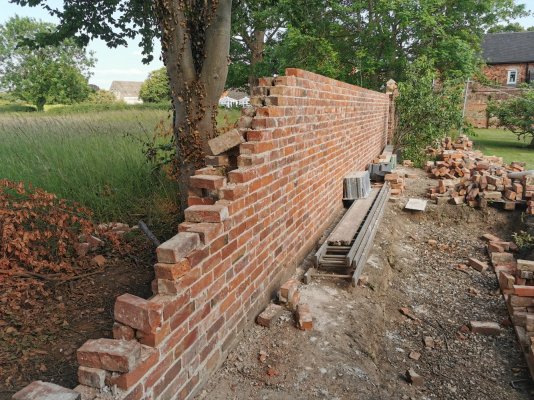

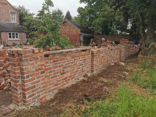

It's certainly better than my 80-ish a day, but only the end result really matters. No one can look at a wall and tell how long it took to build

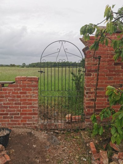

I've not decided what to do with the gate. It's just a recent addition. Any thoughts?
Yes, who am I trying to fool? The gate will no doubt stay for now being more trouble than it is worth to change.If the view through the gate wasn't so lovely I'd be inclined to fit a suitably rustic oak door with heavy ironwork and leave it weather to a silver/grey. Perhaps even construct an oak door frame to exactly match the arched opening . . . I'm thinking of something like an old church door. Not a trivial job, but could be very satisfying.
However, if you want to keep the view then a similar but more 'blacksmithy' gate might be more appropriate.
The real problem, of course, is that there is a perfectly serviceable gate already in place so, if you're anything like me, that would stay while I consider the other options and meanwhile get on with one of the million other things on the to-do list!![]()
We'll no doubt do nothing regarding the gate. It's a bit lightweight but allows a view of the fields.As 'wrought iron' goes, it's a bit naff, but it's blocking the hole, gives a lovely view out and isn't doing any harm.
We inherited a similar sort of 'wrought iron' gate that allowed a view into our main garden from the pavement, so I replaced that with a used timber ledged and braced door (probably from a farm outbuilding) that just happened to exactly fit. Someone took our old one away and was very happy with it.
That's a splendid job on the brickwork! By the time I've picked through my pile of ugly stones and mixed the mortar by hand, I reckon to manage just 0.5m2 of random stone retaining wall in a short day. 100 bricks laid in a 9" wall is (I may have miscalculated) >0.8m2.

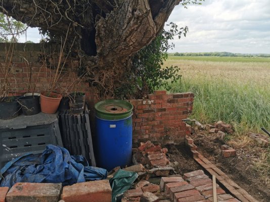

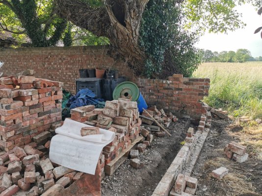

By blending in, do you mean something like changing the footprint of the tree wall to go round it in a semi circle serpentine style?Any suggestions on how to blend the new wall I am building with the tree wall would be greatly appreciated. This is where I got to today. There are lots of bricks to clean up before I start laying again!
The little owls have been monitoring progress and seem to like the new wall.
Sorry about that.... house training was not in my brief.They've been monitoring progress here and pooing all over any tools I've left out overnight!

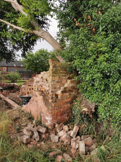

A good question! The tree wall was 80% rebuilt with new bricks but the last 20% at the tree end was cobbled together and not straight... The corner was a total mess it helped by the tree.By blending in, do you mean something like changing the footprint of the tree wall to go round it in a semi circle serpentine style?

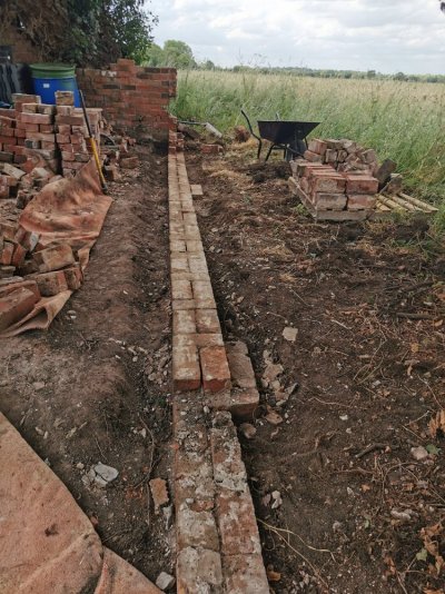

New foundations are always a bit of an issue near trees. Sometimes a wide strip foundation can help, as they don't need the same depth as a standard strip foundation.
It's a walnut tree. A right gnarly old specimen that has lost a number of limbs over the years given the diameter of the trunk and current branches. If it were on my land, I would probably have looked to lop some of the longer branches to take some weight off the remains of the trunk.I've been struggling to identify the species of that tree, perhaps because it's smothered in ivy? If that's right then the ivy is responsible for much of the of the damage to the wall and, unless its throughly eradicated it will repeat that trick. The tree itself looks to be an an old and gnarly example of whatever it is and its roots will be large and extensive. Any excavations nearby for new footings will be severely hindered and perhaps risky to the tree, Also, should you deliberately or inadvertently kill it that would introduce the risk of subsidence as the larger root structures decay and collapse.
