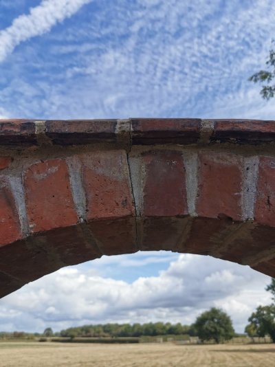

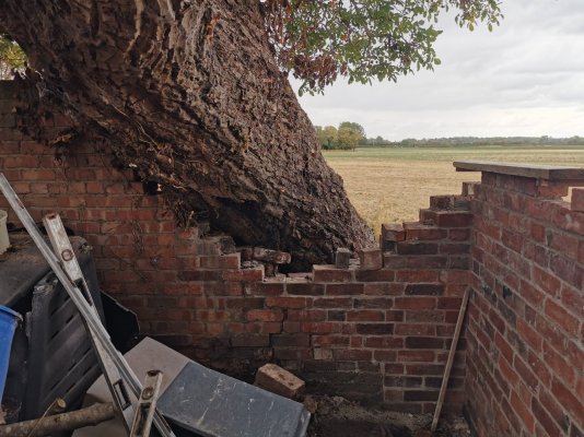

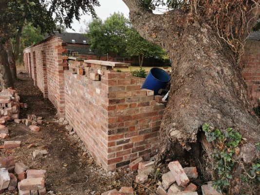

I fear disappointment is inevitable! I shall have to have a careful look at how this will all work out given the existing brickwork to the left and below. I think I'm after an easy life.It could be a segmental arch as well. The easiest solution would be to have 2 stopped ends, and lower the wall inbetween to clear the tree. The only problem with that is you will look at it in the future and wish you'd done it differently. Plus you will disappoint all your followers on here.![]()

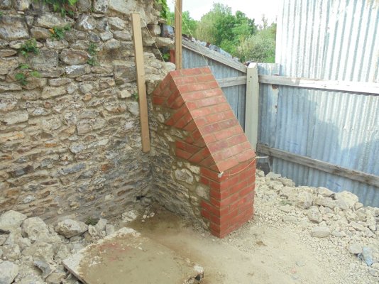

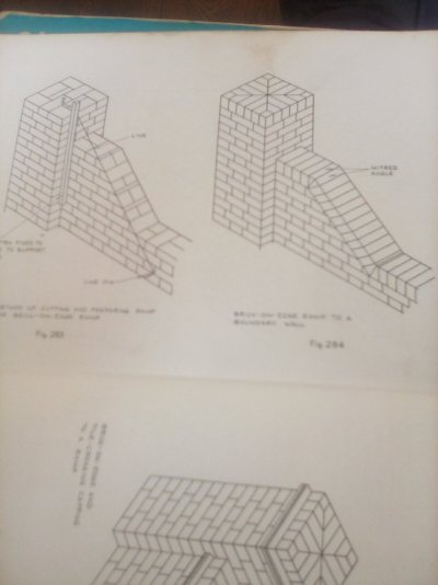

Maybe having a shape like this as a compromise. Cut the angles to lines, and lay the brick on edge to lines. For the brick on edge at the angles the cut should bisect the angle by half, and the other face should be a whole brick. Work out the brickwork so that all the brick on edge are whole bricks.Thanks for the replies. I'm a bit torn on the best approach...
From a time perspective, I feared that the internal arch was going to be mentioned! I agree it will look good if executed correctly. I'm not sure how best to approach it given the irregular shape and angle of the trunk. There would be quite a lot of brickwork to consider on the existing side. Would you suggest a flatter/larger radius arch rather than more rounded?
I could do with making a bit more progress on the wall before embarking on this one - my wife may not appreciate the distraction!
