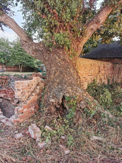

Ideally you want a root barrier installed between the wall and the trees. Be a shame for future damage after all the hard graft.It's a walnut tree. A right gnarly old specimen that has lost a number of limbs over the years given the diameter of the trunk and current branches. If it were on my land, I would probably have looked to lop some of the longer branches to take some weight off the remains of the trunk.
I should probably pull off the ivy again from the tree. Once the owls are finished with their chicks soon. It's a constant battle here. The walls suffered massively from the ivy over the years. The wall I have taken down had ivy growing up between the two skins of brickwork and all over. It's remarkable the damage caused over time. The thickness of the ivy underground that has tracked along the whole length of the wall is incredible. Hopefully, I've dug up enough to disrupt it's return...
I have to expect a few issues in future from the trees near the wall. Hopefully the wall won't be knocked down after all this effort!
